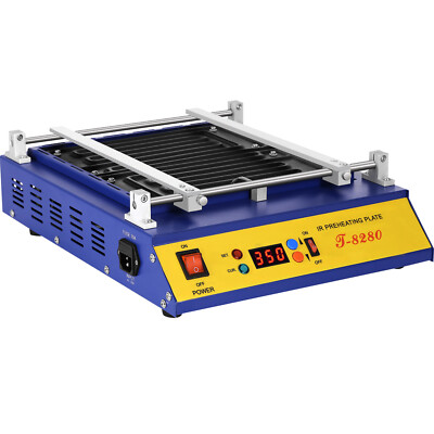

You can try to heat entire board into IR oven.
If boots and get access to its SSD, recover the data as soon as possible.
No, that is just a preheater.
You can try to heat/reflow CPU as first time did.
Once booted (IF), retrive the data...
