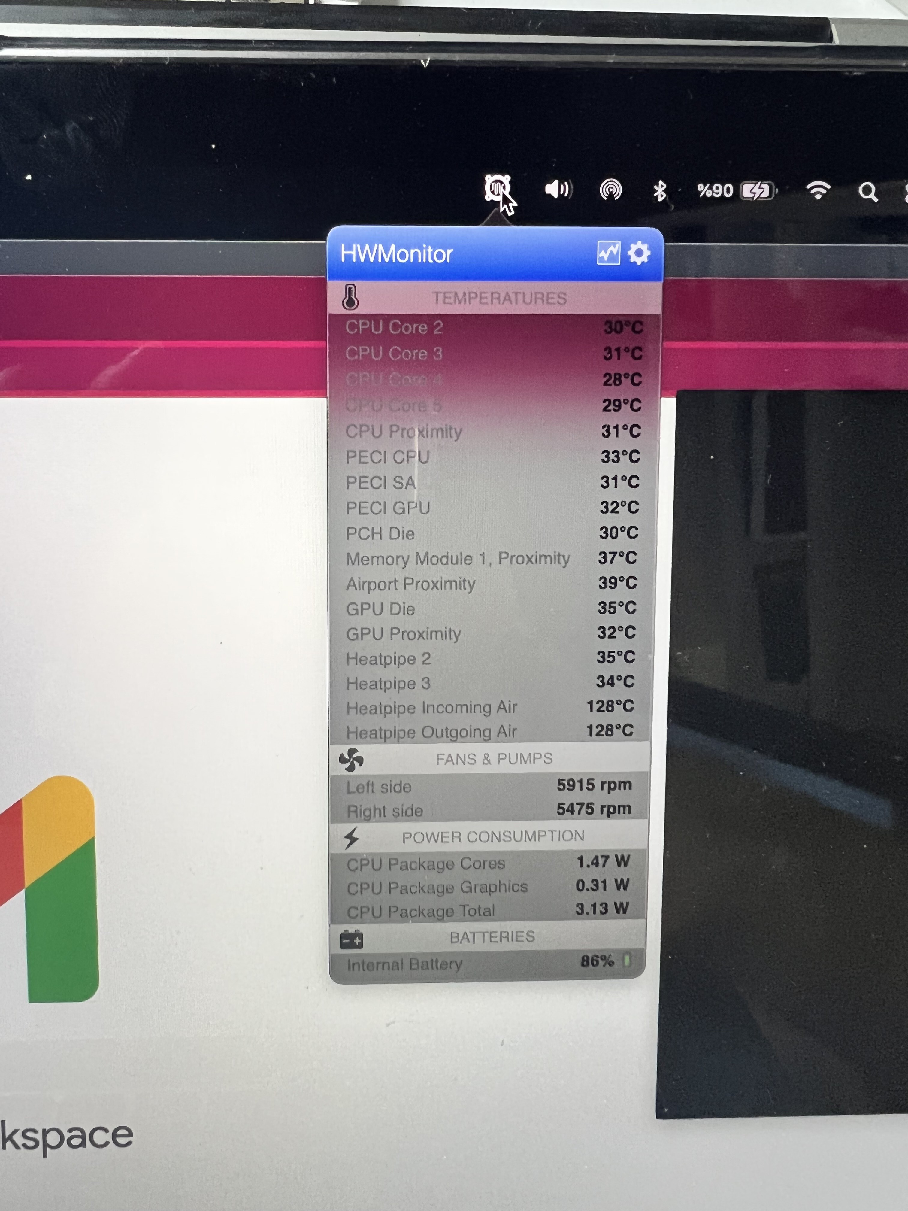

I have my wife's A1707 macbook pro and ordered a battery 3 days ago. Changed it very well (I don't think that I have destroyed anywhere that time) but then I realised that macbook started to work so slow and did diagnostic and gave me PFM006 & PPN001 as everyone gets. But this didnt mean anything for me. So kept searching and found your video on youtube which shows kindly similiar problem. I have made an external mac os, run the hwmonitor and found only heatpipe incoming and outgoing air is around 128 degress. There is no damage on the card when I checked. I checked the trackpad and saw nothing there. Maybe Im missing of course something but really I couldn't find anywhere to look and Im totally new on macbooks. And the fans goes to the highest speed when mac os starts loading.

MacBook fans will spin to max, if trackpad is not detected; keep in mind that.
Some of them (not all) do the same if battery is not connected.
In these cases, macOS runs slow too.
You should test with known good (preferible original) battery.
Be aware, new is not equal with known good!
When the battery is removed from the case, the chance to damage trackpad board/flex is always present.
The best diagnostic, test your board into other working shell.

I have installed the TG Pro and got these screenshots from there. Any ideas now?
I have changed the battery, And still same problem going on. Original battery flex cable has been torn off so I cant try it again. But here are the screenshots of TG Pro, HWMonitor and activity monitor. These screenshots been taken after waiting a bit.

You may have problem with U5870, or its related components.
But I still think about damaged implied when you've removed the old battery.
Trackpad still doesn't appear on System Preferences?

This problem been solved with changing the trackpad. I was all caused because of the ripped tmp sensor on trackpad while changing the battery. Thanks for your all help
