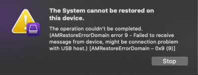

Many 3V3 rails are present, but no 5V rails. I thought this was beginning to sound like a T2 firmware issue, so I started down that road as well. Using Apple Configurator 2, I've tried the Actions -> Advanced -> Revive Device option several times with the target machine successfully in DFU mode. No joy...

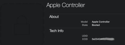

CD3215 replaced and the board now pulls 2.885A @ 19.5V. Trying DFU Mode -> Advanced -> Revive process now.
ViBe
After a couple of tries, (and errors), Apple Configurator 2 silently stated that the Apple Controller booted. I have fan spin, keyboard backlight, and USB mouse has a light, too. No backlight or image, and no HDMI output using a USB-C dongle.

Booted! The display works MUCH better when it's plugged in... Case closed.
