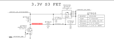

On Q7910 I have 3.3v on pins 3 and 4, but pins 1,2,5,6 are all zero and not shorted to ground.
It looks like Q7910 is bad, anything else I need to check? Board is pulling 20mA from charger.
Pin3 should be low.
Read how a P-channel MOSFET works...
This board doesn't start by itself.
Use power button, or R5014/15 pads instead.
rsiesta
Duh, even in red... I missed the _L I was thinking it was P3VS3_EN. I knew some required starting, this is first one I have had. That looks like it makes it easy as it started and pulling 1 amp from charger, The keyboard looks nasty I bet the on off button is not working... Thanks!
