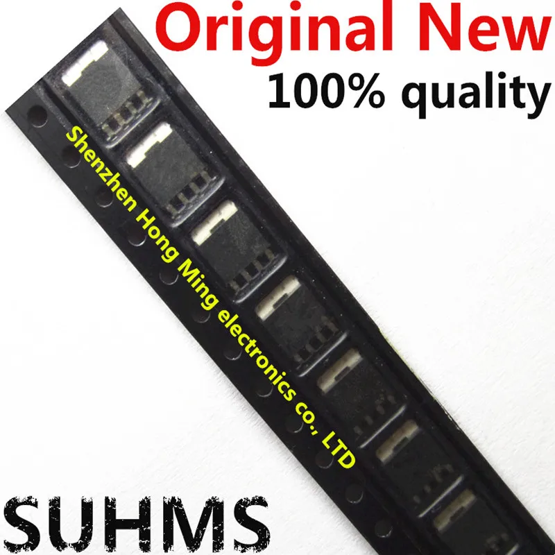

Ok got another 2011 macbook with a faulty GPU but working charge circuit and took some multimeter readings of Q7030 and getting 45 ohms between pins 1-3 and 4 compared to infinite resistance on the bad charge circuit. Q7035 has probably worn with it at same time according to what I've read.
R7051 and R7052 are measuring at 15.5 ohms and 0.5 as oppose to 2.2 and 0 so ordered replacements.
I've had to order Q7030 (K0332) and Q7035 (K0305) from china Aliexpress as couldnt find a UK source so likely going to be June/July when I install these.

Ok changed Q7030 and Q7035 and both getting super hot.
Source links here cpc, rs online and other electronic suppliers dont seem to sell them in the UK i could only find ebay for single components in france with expensive post
I don't suspect the MOSFETs.
Check for knocked off, or moved components.
Be sure to have good solders and check all traces.
Pay atention to C7025.
Post basic voltages of U7000 and diode mode to ground at PPBUS_G3H.
