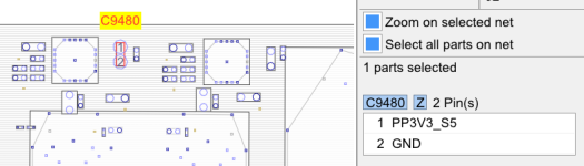

Measure PP3v3_S5 anywhere on the board in diode mode and I get 0.000. :/
I can't turn this board and see what gets hot, as I don't have the rest of the chassis, is there a way to calculate where the short could be?

gcain
Took y our advice and bought a 10A supply.
Found the short in under a minute.
So now I get a green LED and nothing else. Shorting SMC_ONOFF_L does not get the fan to spin.
Not being familiar with iMacs I don't know if I can turn it on with no screen, button etc attached; so should it be turning on when shorting SMC_ONOFF_L at C600?

Ha! You're actually right.
How can the Boardview say one thing and the diagram say another....
Either way, the short on PP3v3_S5 went way when I replaced that cap.
