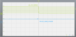

First to see which rail causes this hook up your 2 channel scope to both CPUVR_PGOOD and ALL_SYS and trigger on the falling edge to see which one drops off first.
smiba
No Title
ALL_SYS_PWRGD drops before CPUVR_PGOOD drops.
I guess at this point its just a matter of going through a whole bunch of power signals to hopefully see which one goes first? CPUVR_PGOOD would be much easier :(

Now comes the shitty part in separating the ALL_SYS signals and see which one falls first. It seems like ALL_SYS is not a "hard" drop and it gradually drops to zero. What is your time base in that picture?
4μs/div by the way
The wait is the worst, at this rate its going to take a couple of days...I already confirmed PP1V35_S3RS0_CPUDRR not being at fault and I'm currently testing PP3V3_S0.
Are there any power lines you recommend taking a look at first?
(On the picture the voltages you see on the side are for Probe A and I didn't align B. Sorry for the unclarity. Probe B is seeing normal 1.35V)
U7200 is on my suspect list but I would have expected CPUVR_PGOOD to drop before ALL_SYS. Resoldering it with an iron can not hurt, just don't use hot air or it may disturb the actual problem.
