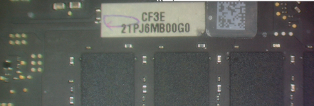

I've tried to figure out the exact model of the board, but I can't find it engraved on the board anywhere.
The only number that I saw was this one on the img, glued on that component, and because i found a boardview with that exact number, I assumed that it was the board number. Isen't it?

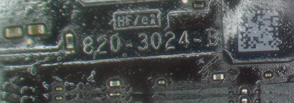

Hi,
I can't figure out what is the board number. I can't see it anywhere.
