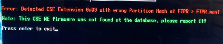

I have one more question. I was curious if EFI hasn’t got corrupted and after putting dump in ME Analyser I got such message (picture in attachment). I’ve never got such message. Is it normal for newer EFI, or should I clean ME region/take “new” clean dump and reflash the chip?

ME Analyser doesn't recognize that ME properly, maybe.
Don't touch BIOS yet.
Get Medusa programmer, if you want to stay in business with Apple repair.

Reflashing EFI did the trick, computer starts now, loads system. Now I have 2 other problems:
- I've changed the fsys region in bios you sent me with the original bios fsys (I've copied everything from this region) but S/N doesn't show up in "this mac" info, also when I want to run diagnostics it shows me, that mac doesn't have S/N, and I can't perform diagnostics.
- keyboard doesn't work at all. With external keyboard it works fine, but internal doesn't react even for power button. Can it be related to bad SMC or bad soldering? I don't have another keyboard or topcase to replace it.
EDIT: I've edited bios you sent me and replaced S/N only. Now diagnostics works, S/N is visible in "this mac", also keyboard works perfectly. I think without S/N board wasn't able to identify itself and that's why keyboard was off.
Computer is repaired, @2informaticos, as always thank you for support! If not damaged SMC which I have used for the first time it would be repaired earlier. What to do, in such market situation sometimes we have to cope with damaged components from donor boards...
