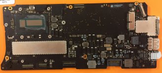

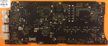

[SOLVED]820-4924 Charges but cannot run on battery only.
bjf
Any idea where to start with this? Liquid-damaged, but spill was pretty minimal. I included pre-ultrasonic pics.

Define "charging" an orange light means nothing. What does OSX say about the battery and is percentage increasing?
bjf
Yes, for sure, orange light means nothing. The percentage is actually increasing. That's the weird thing here. OS X doesn't have any issues with the battery, all normal stats, no Replace Soon message or anything like that.
bjf
Nevermind, blown D7005 and R7005. I overlooked them in my search for a much more complicated problem. Thanks.
