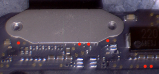

I have this one with no image or backlight on internal screen. External screen works fine.
History is customer tried to replace cracked screen (which had image and backlight but with broken LCD). He somehow replaced the screen with the power applied and now no screens are working. Also not the original broken one. Tried two new known-good ones. The original with crack also works i another machine. So logic board issue here.
If something shorted because of connecting the screen while powered on what would be the first suspects ? I cannot see or smell anything burned...
PP5V_S0SW_LCD = 0V
PP3V3_S0SW_LCD = 0V
EDP_PANEL_PWR_EN = 0V
PANEL_P5V_EN = 0V
PANEL_P3V3_EN = 0V
Damaged connector would be a first suspect. Next would be a diode mode test on all pins. Both screens have a LCD cable, you did not swap that over so that could be the problem?
Also inspect for damaged/knocked off components around LCD connector, easy to do with tool or nails.

Connector on logic board looking perfect as well as connector on LCD board also have no visible damage. I tried already with several LCD cables. Also all components around this area are in place and with none visible damage.
I will take the diode measurements on the LCD connector but I can only do it with the LCD (cable) disconnected as the connector is put in from the top in this model. Would this be fine ?

That looks ok. Make sure to check all caps C8520-29 for damage. If that is ok then the sucky part of checking power to the LCD on pin 44 and 45. Check while powering on as there may only be power there for a second if no screen is recognized.
That is what happens if no LCD is connected. I'm still suspecting the connector, pins 1,3,4,6 are important for LCD detection. See if they have continuity to the other side of the LCD cable.
Power pins too of course 44 and 45.

Pins 1,3,4,6,44,45 have continuity to the other side of the LCD cable. I measured from nearby probe points as the LCD cable connected is making it impossible to measure on the connector directly
Pins 44,45 were measured with LCD connected if there was a pulse? Need to make sure they also have that voltage when a load is connected. This one is getting annoying. There is of course the possibility that both LCD were fucked up somehow.....

Pins 44,45 have spike with both the screen connected and disconnected.
Both LCD are working for sure because I have another 820-00875 that they work on. I have tested with three displays (two good ones and a cracked one). All three working on good board. None working on bad board...

SMC_LID_LEFT = 3.37 V
SMC_LID_LEFT_R = 3.37 V
SMC_LID_RIGHT = 3.37 V (only with audio flex cable connected in J6600, otherwise ~10mV)
HALL_SENSOR_RIGHT = 3.40 V (only with audio flex cable connected in J6600, otherwise ~10mV)
LID_OPEN = 3.37 V
LID_OPEN_R = 3.40 V
Kind of out of ideas right now. Experience with these is still limited of course. Got a working board to compare things with? See what happens on BUF_EDP_PANEL_PWR_EN too.
