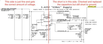

820-3476-A Short to ground around PP3V42_G3H.
VirtualLife
I have a 820-3476-A that has short to ground. Here is a picture explained where the short begins around PP3V42_G3H.
I injected voltage to the pp3v42_g3h and the short went away and the macbook started working. Anyways the short came back so what should i do now?
Inject voltage again and see if anything heats up, there is no magic solution for this. It is a flaky capacitor....
