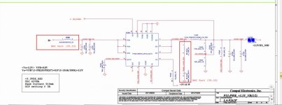

The laptop turns on and all functions work but the SSD will not be detected and I am not able to boot into windows and only into the BIOS. Upon disassembling my laptop I found that one component has burned off my board and I am unsure of the reason. I managed to find schematics for my model and tracked down the component.
The first photo shows the burnt component PL308.
The second photo is the part on the schematic which shows that it's an inductor with the part number BLM18SG700TN1D_2P(?) and it is related to the SSD (3.3VDX_SSD) so I'm 100% sure this component is the issue.
This is the third photo after searching up the part BLM18SG700TN1D_2P I can see that it is also used on components PL302, 304, 306, and 310

I do not have a donor board but I do have lots of boards left around from iPhone repairs and etc. So, my question is, is there a way to figure out what part PL308 was, buy a new one or find similar component from another board and resolder it on my board? Is there a way to measure the value of PL302 to figure out what the component at PL308 was?
