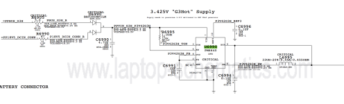

Please forgive me if I'm still not doing this right. I measured pin 4 and then pin 7 of U6990 and i'm getting 9.87 each time. Also I just noticed there is very faint clicking sound when the ac adapter is connected.

I have no idea which board you are working on so I'm gonna assume 3115.
Look at schematic and tell me what pins 4 and 7 are connected to. I want to know the voltage on the PP3V42 rails.
TexpertLLC
Hope this attached pic shows what you are looking for and yep this is a 3115.

TexpertLLC
I am confused as to where exactly I am supposed to take the measurement at? In other words at what component should I measure with the probes?
aprendiz
Moderator
black probe on GND and red probe on L6995, dont forget to turn on the DMM (Digital multimeter).....................

LOL ikr, sorry Im such a newb, you would think after a year of watching Louis I would know this stuff, but I cannot find a single video where he shows exactly where to take your measurements. I really appreciate the help. Okay there is no reading on either side of L6995, and yeah the DMM is definitely on.
TexpertLLC
Resistance to GND on L6995 measures
PIN 1: 1.3 no charger, 1.5 to 1.6 with charger
PIN 2: .8 with no charger, .7 with charger.
Again sorry if that I'm not measuring it right, brand new to troubleshooting board repair. On a positive note I am pretty good at soldering once I figure out what needs replacing.
Looks like your PP3V42 bus is shorted to GND. Pretty sure the shorted cap will be under the sponge next to the BIL connector. Inject voltage on 3V42 bus and see if anything heats up in that area.
