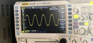

Sorry about the delay to answer your question but I didn’t have te equipment to read the frequency on Y2810 about both questions yes
1) I have the frequency on Y2810
2) when I press power button PM_PWRBTN_L drop to 0 v but nothing else
