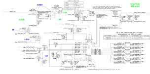

Liquid damage.
Backlight work but only for split second.
Backlight output is 39V then slowly dropping to 0V.
On image voltage in blue is stable, in green is slowly dropping.
