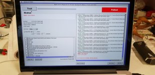

A customer brought in this A1425 complaining about it running too slow.
Nothing unusual about the motherboard besides the common issue with the corrosion on the wifi module (which i still dont get how it gets there).
Booting from an external hdd with yosemite on it i get the attached readings. Any ideas? A1425 Temperature Ratings.jpg

Got an update on this one, after reading some previous posts here, i decided to remove the battery and the trackpad.
Apparently he didnt think it was necessary to report that he had spilled coffee on the trackpad, i ordered a new trackpad cable just to check it because his was funny looking.
Will report back results.
When you run ASD, set "On error" option to "Continue".
Then repeat the test, just in case other error may appear.

Ok, you can mark this as solved. Replaced the trackpad and the laptop works perfectly, no sensor issues, normal speed, everything works smoothly.
Thanks a lot for your replies.
