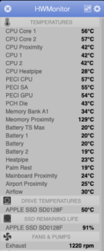

Fans run high. I checked SMC VSENSE and ISENSE sections noticed when checking sensors that PCH_SML1ALERT_L is zero. I'm guessing that's bad news being that R2010 is good and diode mode not showing a short on the line?
