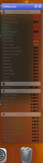

Hello,
I have this board taking a litlle liquid damaged no real apparent oxydation...
There was some dirt near U5620 and U1930...
All sensor looks good in TG Pro and other apps.
Everyhing is working exptect camera and throttling and crazy fan...
It takes at least 30 seconds to arrive at full fan speed
Diode value looks good on camera connector.
Diagnostic talk about SMC and camera.
Already tried the board in another fully working mac assembly with no luck.
Tried me clean too.
Tried to reflow U3900...
I'm out of idea, any help will be apreciated ! :)
Did you test the machine disconnecting webcam?

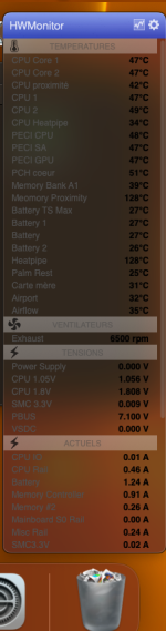

Post a screenshot from HWMonitor sensors.
PCOKAY
Hi, and thank you ! I watch too much Louis Video, i feel like home here... :ROFLMAO:
So i double check and i feel stupid, the flex for the magsafe board was not properly plugged in... that explain the sensor problem.
And the webcam cable is damaged.... i'll check with another screen again this week and i'll tell you.
Thanks for Hwmonitor, i'll keep this one, other software didn't show me the bad sensors just hide it.
