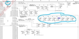

Then you still have problems on USB-C areas.
CD3215 chips good for sure?
Possibly bad solders, broken traces...
iFix

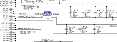

Nothing that seems as a possible problem when checked under microscope all of them seem fine nothing broken in that area. C7651 was broken off complete but i returned it in place
iFix
The U7000 that i replaced was used and not good probably i found old stock new U7000 replaced it after i git the EN signal on U6903 but the final solution was D6902 and got 20v powers on now.
