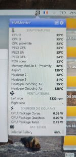

820-00239 High speed fan spinning
yobad
820-00239, without water damage, the board is very clean and I tested it in a known good MacBook.
It looks like the sensor issues, but the client reported that it’s happened after it stuck while an update, not water damage.
I booted from an external driver to get the sensor reading in the attached scre
any suggestions
Thanks,
On the working board, both Airport and Heatpipe Outgoing Air sensors report normal values?
Machine got stuck when updating to newer macOS?
In such case, you can try new full BIOS, clean ME.
Airport is normal on this board but Heatpipe Outgoing Air sensor should not be 128 Celsius. That is most likely the reason for the high fan spin
