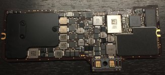

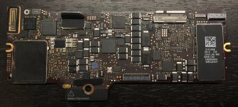

820-00244 Has 20V but no current.
bjf
I'm getting 20V on this board and PPBUS is 8.6V but board is not turning on. The board is pretty clean and the few components that looked bad I replaced. The one area that was hit right under the LCD connector is measuring the same as good board in diode mode on all the components. Not sure what the next step is with these boards because I don't touch them normally. I attached pictures of the board before ultrasonic cleaning.

Do you get 3V3_S5/SUS?
All RTC signals good?
Check if PM_PWRBTN_L reacts (drop pulse) when trigger SMC_ONOFF_L.
Be sure PM_RSMRST_L is always high.
