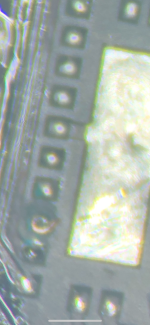

Looking around the area closer I discovered what could possibly damaged pads under a chip just to the north and east of U2800. I pulled it and found three damaged pads. One I am not sure where it goes. My schematic does not show this chip.
If you had a board view with this chip it would be helpful.
board shows up as 820-00840-01 but this chip is also present on my -A boards.
I have one pad that is in question.

I was able to get a micro drop of solder on the nub anc curled a jumper I green'ed in place. Wish me luck because I have no idea where this pad goes.

That is USB redriver, already posted Aliexpress link to buy it.
The problem is no schematic shows this chip...
I had a board working without that chip, but no USB device recognized...
