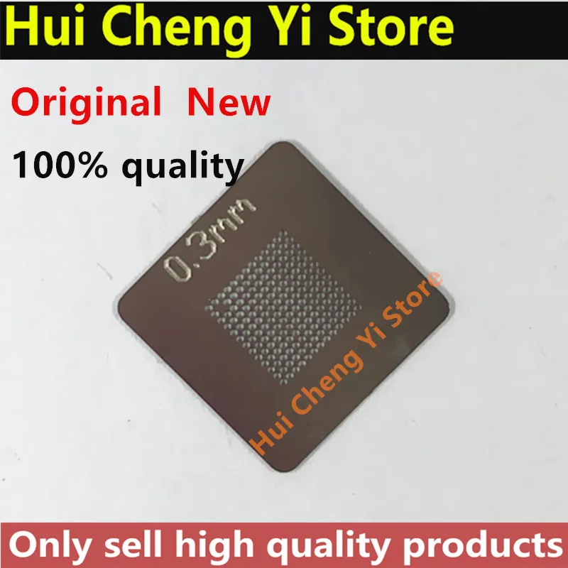

Do you have a suggestion on how to get started on reballing? Source for stencils and materials for Apple boards?
You can't reball a dead chip!
Do you think wooden foot massage helps for something???
Get another SMC from donor board, same model.
Aliexpress has necesary stencils for any kind of SMC.
Just do NOT buy flux there; avoid "chinese honey" use on repair process.
I personally reball with solder paste and direct heat stencil.
Many videos available on Internet; practice on scrap boards/chips...
