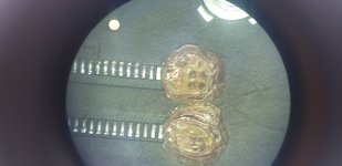

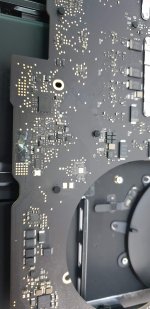

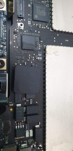

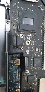

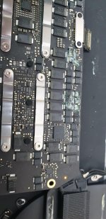

Hello,
I'll give a quick description of the original damage and what I've done till now and then provide some measurements.
I've attached photos with the initial damage and after removing the short on the trackpad connector.
Initially, PPVIN_S4_TPAD_FUSE was shorted and the short was removed by digging 2 holes in the board.
PP3v3_G3H was shorted as well but after injecting current it went away immediately.
I had 5V looping on 2 ports so i reflowed one of the CD3215 (UB400) and now I had 5V stable. I replaced the chip with another one C00 but same 5V stable
I then checked the other 2 ports and they are looping 5V now.
I replaced both CD3215 (U3100 and U3200) on the looping side with no change. So here are the measurements now (After cleaning and drying the board)

I replaced both U3100 and U3200 and they are still looping.
Obviously i can't confirm 100% the CD3215C00 I used are good but i don't have any more on hand at the moment to keep on replacing them.
Is that a CD3215 issue or it can be something else?
Summarised:
2 USB ports are looping at 5V the other 2 have stable 5V. The looping kept even after replacing both of the cd3215
I have no thermal camera and i can't feel any of the USB controllers to get warm.

The looping ports should be good.
This symptom appears because board try to starts and something else trigger a protection when try to switch to 20V.
You must work on the "fixed" ports, there is a problem...

Diagnosing USB-V areas is not easy job.
And liquid spill is the worst case, as various BGA chips can be affected by (probably) crap accumulated underneath.
Usually, cycling every 5s is sign of board tries to boot on that port.
Some sensor is then triggered and SMC resets the power sequence.

The original liquid damage was affecting only the middle of the logic board, both sides that contain the USB controllers were untouched.
Is it worth stocking another 4x CD3215's and replacing all of them together?
Any guidance on how to proceed to diagnose this is appreciated.
Liquid on the centre is bad; CPU can be dead now.
At least one USB-C area has been affected too, as you have different USB behaviour left to right.

Do you get now similar readings on all CD3215 chips?
You could have a problem witht the ROM chip, or USB 3/Thundernolt controller from that USB-C area.
Maybe bad traces, solders...
