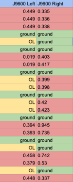

I have a macbook here that the customer ran an update on, after this, the macbook started to become hard to boot, only booted sometimes.
When i started troubleshooting i couldnt get it into system at all.
Data very important
Things tested:
Safe mode several times: boots to blinking question mark folder after loading for ~3 minutes
DFU revive several times: errors every time you try to revive
Replaced the bridge piece that goes on J9600 twice
Target mode works temporarily, once you click on the disk in disk utility on the host machine the entire host machine hangs and stops responding, needing a restart to work again. If you avoid clicking on the disk in disk utility and instead try to directly clone the disk it unmounts itself.
I have attached diode mode readings of J9600, "left side" is left when SW5200 is to the right of J9600
J9600 should be good, if SSD is detected in Target Disk mode.
Check for corrosion around NAND chips; some resistors, or caps may be affected.

Edit: the diode values i got are very different from openboarddata.org values, you think its fine?
