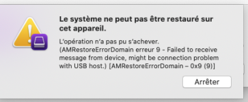

820-01041 No boot but 20V on usb-c
ALWAYS check PPBUS_G3H WITHOUT battery.
If battery is connected, PPBUS_G3H is automatically adjusted, accordingly with battery charge level.
Do you get SLPS2R voltages?
Try to put in DFU restore mode.
raainxx
i try to put in DFU but i have an error when i try to restore, i attach the message.
i have PP1V8_SLPS2R=1,78V , PP0V8_SLPS2R=0,8V but not PP1V1_SLPS2R=0V

Read more posts about DFU restore.
Many people complain, not easy to get it done so fast.
Try all the tricks they mentioned.
