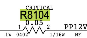

I found another board's schematic/.brd that is essentially identical, and narrowed down the problem to resistor R8104 which is supposed to measure .05 ohms but is actually resisting at .4 ohms. It's the only component between the power supply and the 12v input to the LCD backlight driver LP8561, and the 5v and 3.3v inputs were good. So, I'm trying to find this resistor to replace, and I'm not sure of its specs other than .05 ohms and its size. I've attached a screenshot of the schematic. Can you tell me what I look for to make sure the replacement is compatible? thank you!!

never mind, I plodded along and searched through digi-key long enough to find what I was looking for "RES 0.05 OHM 1% 1/16W 0402"
0.4 ohms is a good reading.
You have to include the multimeter cables there, which are not 0 ohm!
Which schematic using now?
As I said, 0.4 ohm reading is good.
That resistor is for backlight and seems that you don't get internal image; backlight appears later.
Be sure F/L/R4400 are all good.
If you get 12V at pins 2-6 of J4400, check if DP_INTPNL_HPD goes high.
