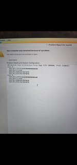

Got this MacBook with no display.
When disconnecting the battery and touchpad it boots to the system, but if either is connected it will not display, or sometimes the Apple logo and kernel panic.
I've replaced the touchpad and battery and still have the same issue.

Now I f up the T2 firmware and it won't boot any more.

Turns on and goes to the system only with battery and touchpad disconnected
I've swapped the logic board on another complete, fully working mac and the problem is the same.

I could not install the system again on internet mode.
Every time it goes to globe and after Apple logo it reboots.
I enter in Target disk mode and cloned the system from another mac, and it boots to the system again. (Battery and Touchpad disconnected)
Only battery connected no display and looping, fan swoosh high speed every 1 minute.
Only touchpad connected, it shows Apple logo and them message this mac restart because of a problem.
