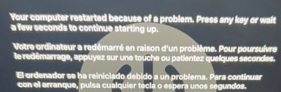

Hi Again!
the macbook is turning on. show apple logo for a long time., no progress bar. After a while it gets to log in page. Cursor runs slow and is not charging.
