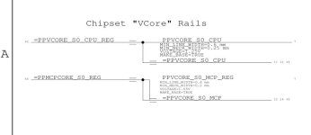

hello friends, i am just working on that board. MCP still original with edgebonding, seems not touched.
got it yesterday. problem turning on, led is constant on, fan is spinning, no display.
i checked the power rails
seems to be all there
the PP5v_s0 is 5.11V , is that ok ?
the only one what i missed is PPVTT_S0_DDR_LDO
DDRVTT_EN is 0V as well
need some help here.

found now in the corner left from the cpu under the cpu coil some korosion. this should be the problem. I will try to solv it and report back.
Dozer
i replaced now all the resistors and caps ich were looking bad
still i had to solder 2 wires
one from R7123 Pin2 (CPU_VCCSENSE_N) to R1101 Pin1
second from R7122 Pin 1 (IMVP6_VSEN_P) to C7131 Pin1
now I have CPU Vcore 1,0V
but still no display
Dozer
I heated up 100C the GPU and voila display is coming. So after replace GPU should working that machine. :)

I checked already U5570,5500,5550 and the area around and the q5503,5501
everything looks good and i measured in diode mode and compared with a donar board , same values
PP3V3_S0 is present
the i2c lines are 3.3v and have some data
