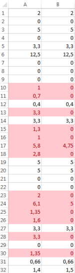

I have soldered a 216-810005 that I found here and voltages are ok, I just need to figure out that resistor you mentioned, almost done!
At the moment I don't have LCD_BKLT_EN. Help please!! I know this signal is given by GMUX
Does it recognize the screen? That comes first before LCD_BKLT_EN. Is LCD_PWR_EN present on U9000 pin 1?
Nope, 0.012v. What is required for GMUX for this? I don't know exactly how it works. LVDS_DDC_DATA is 3.3v, pullup resistor is OK
Now horizontal lines and a bit red screen. I've seen many people with this... Fuck this shit...
