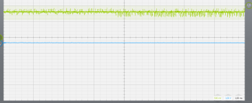

Just guessing at the moment, I already verified if the clock signals are working and they are. I also know the SPI chip does have a little bit of I/O, but too little for it to have actually fully loaded its data (I know it usually is at least 4 times as much)
While I was at it I just probed PPVCORE_S0_CPU and it looked like the following.
Is this an acceptable amount of noise on the CPU power rail? It looks a bit high to me and I don't think its interference from my oscilloscope, it disappears if I disconnect the power. What could be causing this to happen on both AXG and VCORE

You are making this way more complicated. Is CPU Vcore present now? If there was corrosion on U7400 it may be somewhere else too. Inspect closer
CPU VCore was always present, AXG usually is present now. I have yet to find a pattern in why it is sometimes 0V and sometimes ~0.8V
I'm confident there was no other corrosion on the board other then a little on U7400 and a few test pads. I cleaned off the corrosion of parts that were affected by it and verified their values were as expected.
At this point I'd say you are right and U7400 is an unlikely suspect. What is the right suspect, I dont know? Probably a resistor somewhere or maybe the CPU just randomly decided to die
