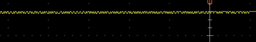

I took out my rigol and normaly I can get the lines big inuf so I can see it going up and down somehow today.......pffffff
pin 6 and 7 both vmax jump between 3,2v and 3,6v
pin 6 and 7 both vavg jump between 3.02v and 3.06v
pin 6 and 7 both vmin jumpo between 2.v and 2.4v
line is like picture, voltage set on 1 volt

Yeah I suggest you first find some Oscope tutorials. You need to set the time base to match the expected signal, also select DC coupled. There will only be a short burst of data on this bus after power on, this will be hard to catch so you cannot mess with the scope to find the correct time base.
QUOTE]
aa did not know that i was measuring when the system was on already.
yes indeed some tutorial would be nice MJLORTON seems to explain it good.

It says nothing, it is just a voltage. There is no data by the looks of it. The burst of data on this bus will be very short and you will need to "catch" it. No idea if your scope can store data like that,
