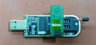

I am starting from scratch... It looks like it is a WSON8 package,
anyone suggest an adapter or how they built one?
Looks like the only ones for sale are around $100, is that the best choice?
From other posts it looks like I can use a EZP2010 programmer, just need a jig to mount the chip in.
No Title
Easiest way is to use Medusa 2...
Classic way, remove WSON8 chip and solder it on a SOP8-DIP8 adapter.
You need to tap part of SOP8 pads...
