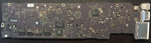

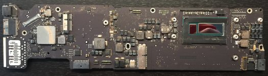

This board is working but it's not doing the 3 fan spinups when you first plug it in, it just spins up once and boots like a 2015 model. I attached some pre-ultrasonic cleaning pictures. Any ideas what might be causing that?
"This board is working"
Does it really work, or just stays on?
You must check for corroded/broken traces and components with bad terminals.
You can also try new BIOS.
