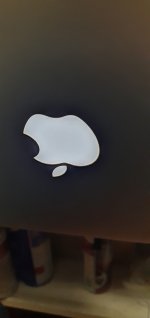

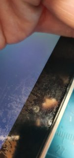

so when I plug the ssd and speakers I do have a chime and a backlight but no image and fan at max level
I do get
on J8300
40V on pin1
5V on pin 28,29,30
L7710 - 10V
