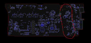

820-4924-A Water damage, PPBUS_G3H fluctuate

If I do this correctly I get 5.2 Kohms on 17/18 and on 27/28 I get 20 ohms
I measured 17/18 on C7150 and 27/28 on C7120 if that is correct.

"If I do this correctly I get 5.2 Kohms on 17/18"
There is your problem; you should get 3 ohms aprox!
Check R7051/52 ans their traces to R7050.

I can't find R7051 and R7052 in boardview though. I can find R7050 and that is exactly where the corrosion happened.

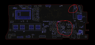

Sorry, I should write R7151/52...
PatricF
R7152 2.4 ohm
R7152 5.8 Kohm
So I'm guessing R7152 is shorted to ground/faulty here?
When trying to measure R7152 I just touched C7150 and it broke of. So I will need to get replacements for at least R7152 and C7150
