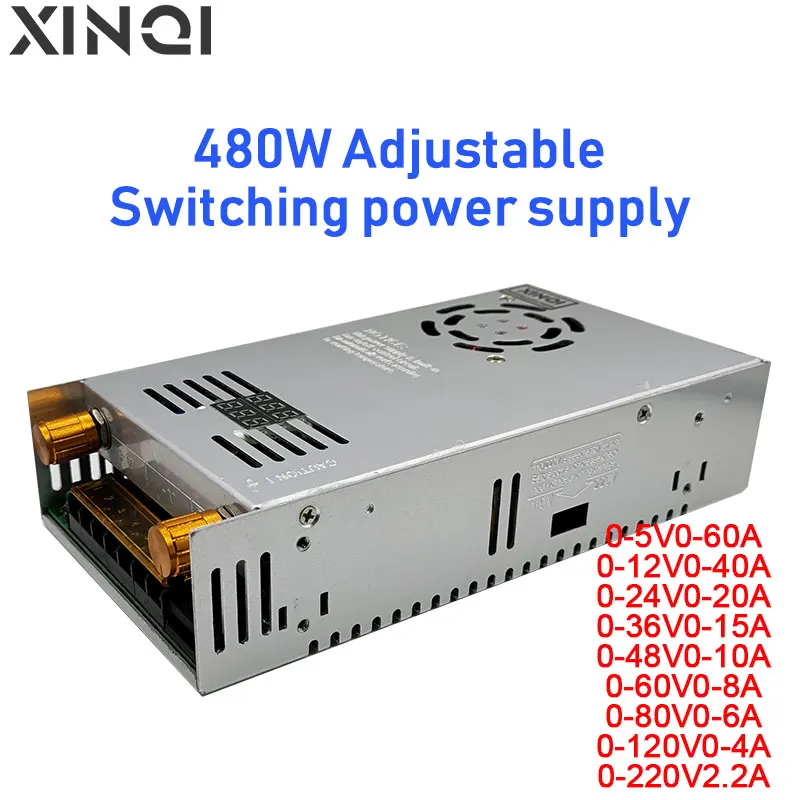

Is that 5A power supply.
If yes, doesn't serve for voltage injection.
You can find few links in the forum, about 20A adjustable power supplies.
The pictured setting injects only 4.3W, not easy to detect; if PSU is not already in protection mode.
Thank you for the help. The DPS5020 on eBay looks like a great choice. This is a DC-DC power supply however. Can you recommend an AC-DC power supply that I can connect to this so I can use it?
