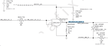

3V3_S0 is not shorted, and i don't have P3V3S0_EN (0V).
I have 3.3V on PM_SLP_S3_R_L (R8178) but 0V on PM_SLP_S3_BUF_L (R8185) witch i think is needed to create P3V3S0_EN, so i think that it may be the U8180. Am I right?.
Askaleto
If you have 3.3V on R8178 ( M_SLP_S3_R_L ) or on the probe point connected to the pin 1 of U8180 and you have 3.3V on C8180 (connected to pin 5), then you need to change U8180.
U8180 has internal pull-up resistor.
So, it should generate 3V on its output directly; check diode mode to ground there.
Also you can remove R8184/85/87, one by one, and see if voltage goes high.
