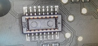

J6100 was very clean, nothing to do there.

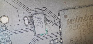

But I have found something that looks like corrosion on U6101.
I have removed it with isopropyl alcohol. Still no fanspin.
highvoltage
One pad was ripped of: SPIROM_USE_MLB. I have to recreate it.
And my fault: I have lost U6101 and I can't find it... 🙈
U6101 is called 74LVC1G99. It seems to be a 3-state gate in SOT833 package.
I have ordered them now. Keep you updated...
