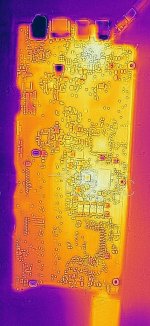

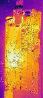

Hi again, I have an A1502 board that started at 26mA for a while, I was testing voltages and at some point, it jumped to 150mA
I was originally missing PP5V_S4 on L7520 but then once it jumped to 150mA it was present.
L7320 & L7310 seem a little low at 1.7V instead of 1.8V?
U1950 there is no pp3V42_g3h but checking L7095 PP3v42_g3h is present.
I have also attached thermal images of the board
Thanks for your help
