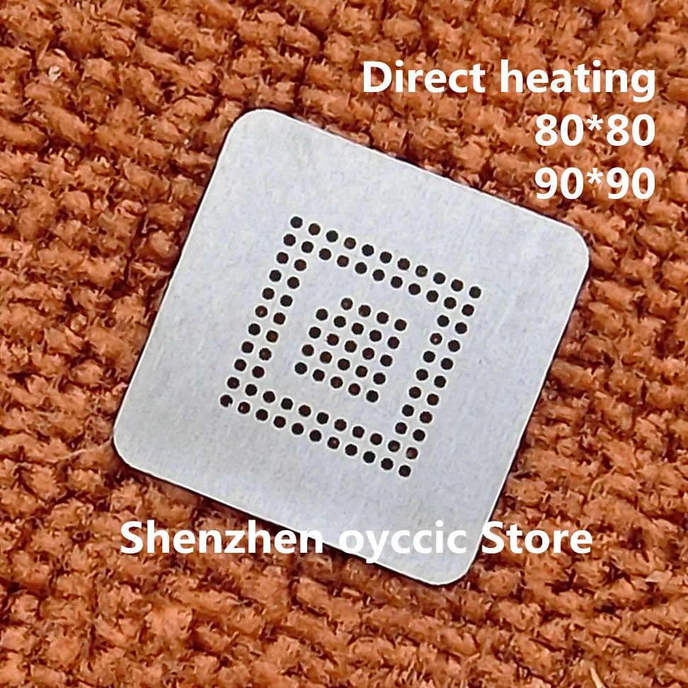

When 1v1 is not present, is that a cd3215 issue ( broken) or could that be an issue elsewhere? Are there any additional checks i could do to verify a bad cd3215.
I use 425degrC and high air to (de)solder them could this be of any risk (i also do eg tristar with these settings and i'm successful with that)
when salvaging cd3215's I guess I need to reball, any suggestion for a stencil?
Use direct heat stencil, with solder paste.
Practice on scrap board, until get confiance.
