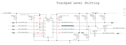

A2251 820-01949-A KEYBOARD AND TRACK PAD NOT WORKING
isc
I test other keyboard but not working
there is no liquids on touch pad or cables or connectors
Keyboard information goes through trackpad circuitry.
So trackpad problem will also let keyboard unresponsive.
Check if J6701 gets all required voltages.
Be sure U6860 and its resistors and traces are all good.
isc
U6860 measurements
pin 1 1.8v @ r6803
pin2 0v @ 2pin ************ SPI_TPAD_CLK missed
pin 3 1.8v @ 3pin
pin 4 1.8v @ r4867
pin5 1.8v @ 5pin
pin 9 3.3v @ r6874
pin 10 3.3v @ r6871
pin 11 0v @ r6875 ************ SPI_TPAD_3V3_CLK_R missed
pin 12 3.3v @ r6873
