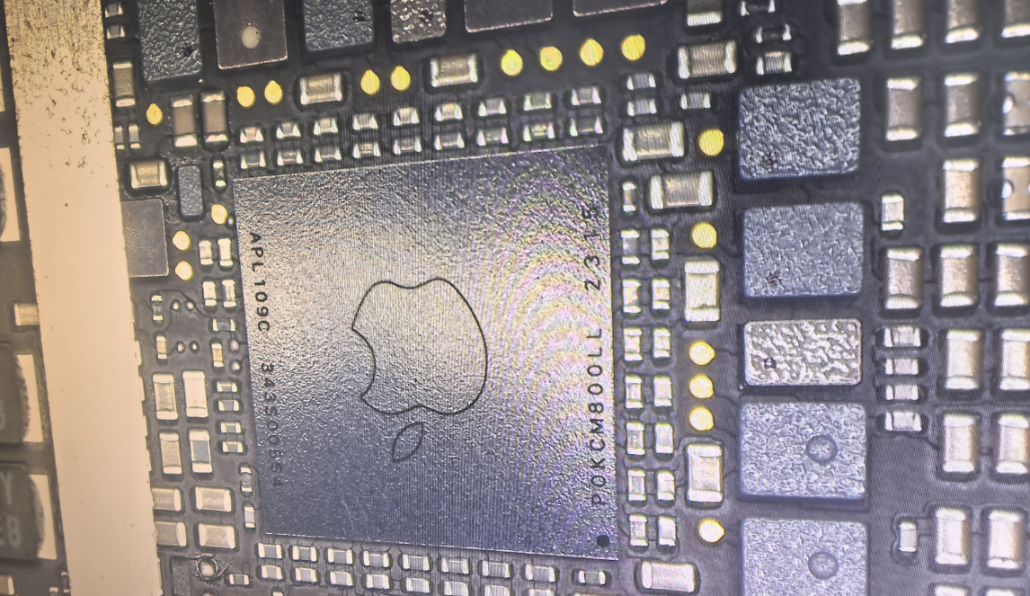

Hi have an A2681 820-02536 with no power.
It has only 4.90V and 0.40A on ampmetter.
I don't know were to start, but on a superficial analisys I found PAVDDN_SDG_R has OL on diode reading, when PAVDDP_SDG_R has 0.562
RR005 = 0 ohm
Can you help?

No history. Client said it just stoped working.
PPBUS_AON = 6.72V
PP3V8_AON = 1.590V
PP1V8_AON = 0V and 0.352 on diode reading
PP1V8_AON_MPMU = 0V
PP3V3_S2_LDO = 1.1V

Diode readings:
PPBUS_AON = 0.582
PP3V8_AON = 0.345
L8430 is overheating. However, I don't have any other similar board to use another one.

It seams U8100 is also burnt (it's heating, after L8430 replacing).
Were can I find new U8100? Can I use used ones from donor boards?
