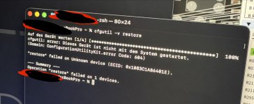

Hi,
the device is recognized in DFU mode by Apple Configurator 2, but it shows as an 'Unknown Device'. A 'Mobile Device Support' pop-up appears asking to 'Install' or 'Cancel', but clicking 'Install' leads to a failure. Additionally, the restore/repair process won't start.
- PPBUS_AON = 12.26V (stable)
- USB-C Output = 5V / 0.03-0.06A
- S2-Rails are also looking good.
- CD commands are also working.

I never faced with such issue.
Possibly CPU problem.
Just in case, erase SPI ROM (U1900) and try DFU again.
Don't forget to make backup first!
I don't see other option.
NAND failure can cause DFU error, but can't impide correct detection of the machine in DFU.
