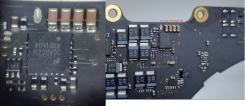

A2780 - 820-02652-A - 5V up to 0,7 amp - no 20V. Stopped working suddenly
samstown
Hello
Macbook stop working all of suden. No light on Magsafe, no 20V so I took board out. No visible damage. I am using schematic 820-02100, I don't know if there is a better one available for 820-02652, nothing on badcaps.
3v8_AON is ok, I have 3.8V
PPBUS_AON between 9.5 and 11.5 V
USB-C only 5V up to 0.65. No 20V
There's two big coil on near batery connector, diode mode .450
I found 4 caps sorted but schematic doesn't match.
Thanks
Sam
samstown
Got the right brdview, CT054 was the culprit. I remove it, Mac is working now. In such case, Is it necessary to replace the cap ?
