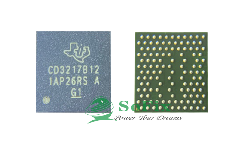

This MLB looks really uggly.
You should identify the bad lines on the J330/JB500 connectors.
For this purpose, I recommend to get S-UEM2 tester.
Is a "must have" tool for someone dealing with Apple T1 and T2 boards repair.
If you decide to continue the repair and detected bad CD3217 chips, then need to achieve them from reliable source.
I again recommend the same seller.
These chips come marked and MUST be soldered in the corresponding position of MLB.
