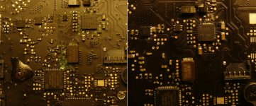

Time to dump the basket 'n board in there. I have two boards to put in there. One scrap board from china with some green and other assorted goop on there, and a water damaged board which I've already got into working state, but still has some corrosion and flux on it.
I first put the boards in 1 minute cleaning sessions in four orientations. This cleaned some of the gunk away, but much remained. I followed up with another sessions of 2 minutes per orientation, so thats 12 mins of cleaning in total. After that, most of the nasty areas looked pretty clean, I think. Before/after images are attached. One particular row of pins on IC 51125 refused to get clean. I cleaned that spot for like ~20 minutes but it wont budge.

With some modifcations, this cleaner will fit 13 and 15 inch boards, heat up fast with a seperate heating element and it does clean shit off of board, even if it takes a little longer than a Crest would.
It is also, at least currently, priced extremely favorably. However, that is all useless if it doesn't clean properly. Due to my lack of experience with these cleaners I dont know if the cleaning is any good. The boards I tried the device with weren't terribly badly corroded to begin with. I'm going to quickly try and get me some more seriously nasty boards so I can run those through. I want to hurry this up, because if this cleaner is poor I want to try and return it ASAP. Hopefully I can get some shit boards quick and post some results.

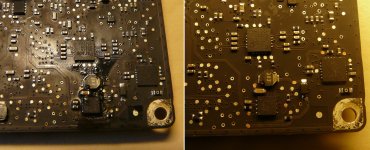

I finally got my Crest CT500, filled it up with the same solution I had in the Emag cleaner and put in the same board I had in the Emag. Results not too impressive, see image. This is some stubborn corrosion. The Crest heats up a lot faster, though I still got me an immersion heater for it which speeds things up a lot.

It's working well, boards are coming out as clean as I'd hoped. I can't compare it to anything besides Allendale, and even that comparison isn't based on anything substantial. The one board I tried to clean in my posts above turns out to have had extremely tough corrosion I doubt any combination of cleaner and solution would've gotten completely off without destroying the rest of the board.
