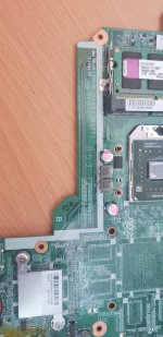

Hi guys, I know this isn't a macbook, but I'm running out of ideas.
I have a hp g6 come in for no mouse problem.
I've googled the issue and found a few different solutions, how ever the ones I've tried didnt work.
I've tried another trackpad, didnt work.
I figure it's a board issue.

Yes on both pins.
however R254 is 3.396v on one side and 17.6mv on the other
and its looks suspect.
Can I run a jumper from pin 1 that has the 3.396v to pin L39 ?
Is that resistor super important ?

Ok I swapped the r251 from my other board, reason I swapped that instead of R254 is because I got the same reading on both boards 17.6mv so figured they was both no good checked the schematics to find a match, R251 is a match according to the schematics I have.
Swapped it over just to get the same reading.
so I'm still getting 17.6mv even after swapping R251 with R254.
There must be a problem on TPCLK signal.

did you start with reflashing EC+Main Bios? do you have "advanced" mode for trackpad in bios settings?
"TPCLK is 0.00i4"
Compare with a good board; supposedly should be less than 1% diference.
Check the value w/ and w/o touchpad connected.
Too low value on TPCLK, practically short...
Check what I told above.
Also remove C509 and check again.
If still low, bad KBC.
